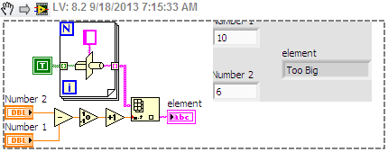

if number 1 is (<,>,=) to number 2 display (greater than), (Less than), (equal)
@mikeporter wrote:
Slightly obfuscated, Jim? Slightly? Smiley Very Happy
Hornless.Rhino one-upped me in the Rube Goldberg thread using the Sign primitive and a ring.  I prefer his solution.
The following is what I had in mind yesterday.  😄  The idea to use the Sign primitive helped me a lot.
Jim
Message 11 of 12
(766 Views)
I was able to solve the problem using Jim's Method...Simple and it works... the ranges on the case selector was a great idea
thanks for all the help
