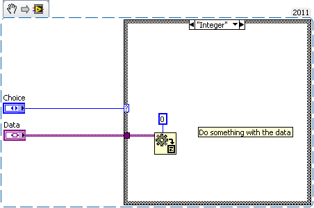

Well if you are using floats and doubles to index an array you may run into problems due to rounding. What element should be selected if the input is 2.5? Still not entirely clear what exactly you are trying to do. Are you trying to do something like this?

i believe Chosing case is not a Problem.   The sub vi process different. One of the case I have explain in the vi above. the Enum data I have to insert into the array. Without the varient setup it is working fine. If you suggent me to remove it altogether. 200 additional case i will have do design.  I believe when i change the enum data into varient and then back, some thing is missing which I dont know about.
