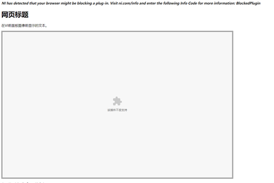

  i imitate an example of Labvew ,release VI to web,aftter i copy URL to web address, VI could not be uploaded to web, and it has an information ,
i cut the screen as follow, and i have changed web browser, such as IE,Microsoft Edge,Google chrome,
i want to know how to solve this issue, do i need to edit configuration of web browser?

Using the supported browser (Internet Explorer) can be the solution to the issue. If there are concerns about Internet Explorer not being supported on certain versions of Windows 10 starting June 15, 2022. A valid workaround is to use the Microsoft Edge Browser on Internet Explorer Mode .
For more information go through this article

Yes, copy URL to IE tursted zone, it shows correctly. i install LABVIEW to the third PC, and i will try ro release to another PC not installed labvew, i browsed from website, my understanding is intall run engine is enough
