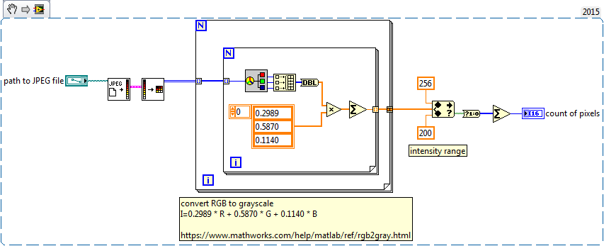

Do you have Vision Acquisition Software? You can use IMAQ image to array to get the pixel intensities.
(4,512 Views)
a way without vision...
(4,501 Views)
Hi zwired1,
May i know, for what purpose you gave an intensity range from 200 to 256 ?
(4,488 Views)
Just random numbers as placeholders.  You will need to put in numbers that suit your application.
In greyscale 0 is black and 255 is white so the range I put it would count "relatively bright" pixels.
