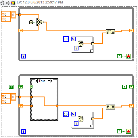

Perhaps a First Call? and a Select node.  Or case structure with a boolean that resets after the first loop:
(4,481 Views)
This totally worked, thank you so much for your help!
