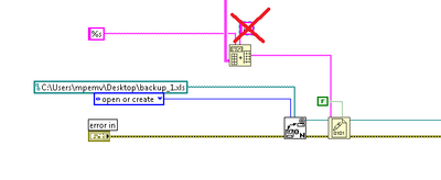

(6,486 Views)
Just remove the string constant.
Message 5 of 16
(6,477 Views)
The file you attached, "backup_1.xls", is not an "Excel" file, despite having the (logically-incorrect) extension .xls.  If you examine it with a Text editor, you can see that it is all text, but with a very strange format:
  • The first line is in tab-delimited format:  "Freq<tab>phase<tab>Z<CR><LF>", where <tab> is the Tab character, 0x8, <CR> is Carriage Return, 0xD, and <LF> is Line Feed, 0xA.  The pair <CR><LF> is the usual PC "End-of-line" Ascii string.
  • The remaining lines of numeric data are just messed up.  They are almost in the same Tab-delimited format as the header, except each number as an extra <CR> after it.  So if the data were the numbers 1, 2 and 3, the line would read "1<CR><Tab>2<CR><Tab>3<CR><CR><LF>".
How did this code get written?  If it was written by LabVIEW, then someone wrote a bad "logging" routine (and put extra <CR> characters after the numbers).  Otherwise, you have the makings of a nice Tab-delimited "Spreadsheet" (not Excel) file that LabVIEW can easily read using Read Delimited Spreadsheet".  Note that this file format is closely related to the Comma-Separated Variables (or .csv) format, which Excel "appropriates" by forcing an Excel-like Icon for these files (and causing confusion in people such as yourself who think these text files are "Excel").
Bob Schor

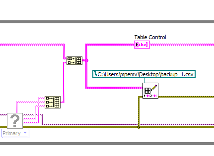

Hi Saed,
did you do any of the suggestions on your own?
Try this:
I don't claim to create "efficient" code, but that should work!
Note that subtle change of the filepath constant…
