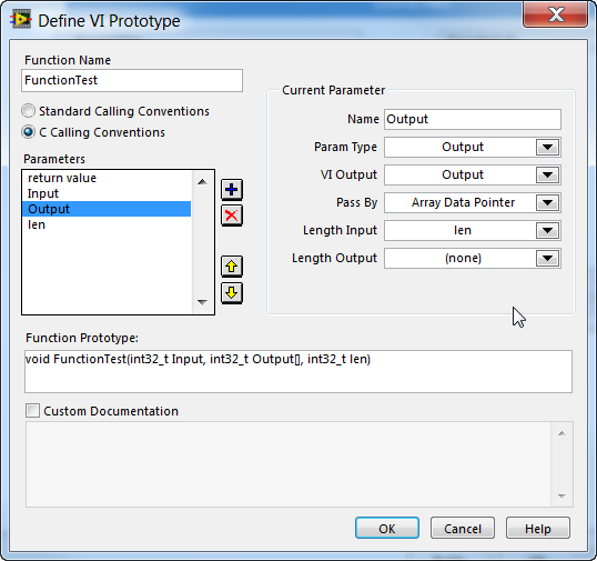

Ok, I don't create DLLs from my LabVIEW code but I think it has something to do with passing the array by reference. You need to pass in an array of the correct (or sufficiently large) size and the function overwrites the data in the array and returns it and provides a length parameter so you can trim the variable. You can also pass the array variable by 'handle' which will write the data back to the original variable (i.e. a pointer). (I don't think my definitions here are quite 'correct' but it should be close enough to understand).
The header information comes from this page that maps the VI to the C-function prototype.
The function can't 'return' the array because you need to know the size etc. of the array and provide the data space or array pointer so I think it can only 'return' scalar values.

Yes you can! You just can't have it as the 'return' value of the function - you get the data by passing a variable as an argument to the function (which the DLL then fills with data).
There's a bit more information about it here: http://digital.ni.com/public.nsf/allkb/862567530005F09C8625649700587C37
Edit: And here's an example in c++ - https://forums.ni.com/t5/Example-Code/Calling-LabVIEW-DLL-in-Visual-C-That-Passes-Array-Handles-by/t...
