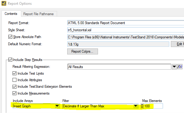

Use a VI to load the CSV and pass the data to TS.
Depending on the size of the file, reduce the data before passing it.
EDIT: I hope you are familiar with TS as such that you pass the data as measurement value. Otherwise, the shown screenshot above will not have the result you are looking for.

Please review the example "Displaying Graphs in a Report" which is part of the TS installation. It should answer your question.
Norbert
