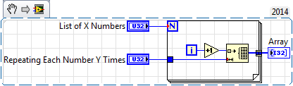

Would something like this be what you are looking to do?
If your list of numbers to be repeated isn't a simple 1-100 just create that array and index that into the for loop to use as your initialize element.

Thank you very much for your input, they is just what I needed. I thought something with using the loop iteration count to do it but was not familiar with the initialize array node. Had to use build array (set to concatenate inputs) due to my older version of LabView, but you sent me in the right direction. Thanks!
