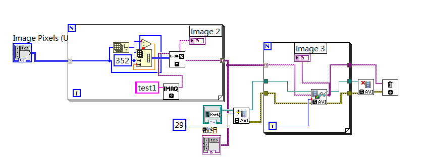

create video from individual pictures by LabVIEW
I have transformed  the .avi into image and got pixels array,and I want to recover .avi(a video format)from the pixels array
Message 11 of 16
(1,586 Views)
回复1.pngIs that right?回复2.pngI run it ,it exits an error
Message 12 of 16
(1,585 Views)
really appreciate for your helpHeart
