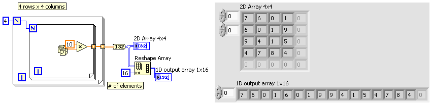

use reshape array and # of elements for dimension size..in your case 2D of 255x255 and a 1D reshape of 65025 # of elements. you were almost there...i re modded your vi.1d_VI.png
