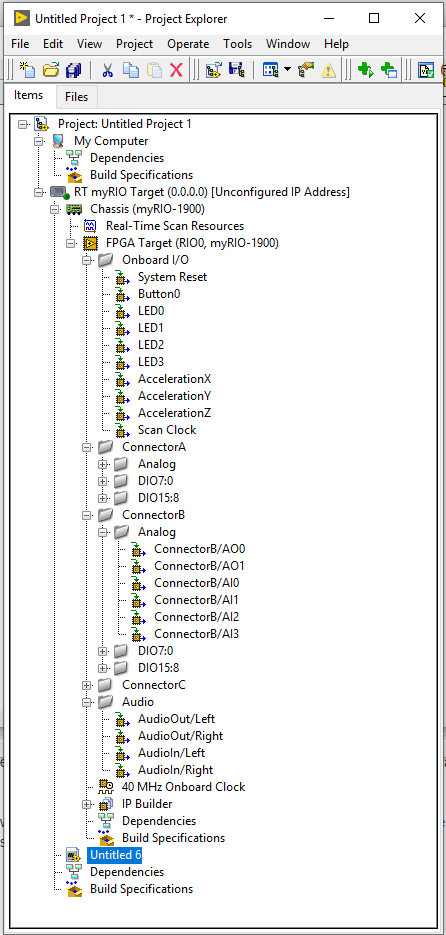

You can create a new (non-local, perhaps non-existant) target directly by opening a project, then right-clicking on the "Project" line (at the very top) and choosing New > Targets and Devices. For me (even without the myRIO toolkit, but with cRIO drivers installed (cRIO is the older-sibling version of myRIO, I guess...)) I can choose myRIO, 1900 from the "New target or device" menu.
From there, I get something similar to what you're showing in Capture7.png, but I have no problem when creating a new VI on that target (right click on the "RT myRIO Target", choose New > VI) and the palettes display normally.
If you want to also do FPGA programming (seems likely), you'll want to right click on the "Chassis" entry and choose New > FPGA Target. This adds a bunch of new items, specific to the 1900. I have nothing connected to my PC at this point. The resulting project file (for me, LabVIEW 2017 32-bit) looks like this:
Untitled 6 is the VI I created before adding the FPGA target (this isn't a requirement, of course, and 6 is just triggered by other things I had open at the time). I collapsed a couple of the virtual folders (grey folders) to allow me to fit it all on one screen.
If you want to connect code that you write here to a real myRIO, you'll need to configure the IP address. You can do this by right clicking on the target, selecting Properties, and then entering the correct address on the first "General" tab/page.
