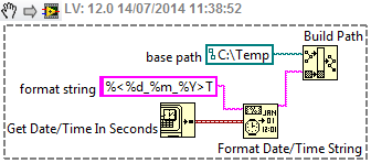

I suspect your problem is illegal characters ("/") in your file path, certainly that is the case in your original vi. You need to format your path, something like this (underscore instead of forward slash):
