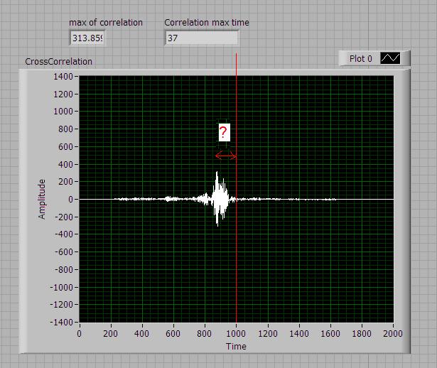

I have a project, where i work with 2 microphones, and i want to calculate the time delay between the two signals. I had made a simple method for it, but it's a bit bad...
So now i  try it with crosscorrelation, but i can't get a correct time-format...i had made the correlation correct, i have just some problem with the time format...
If i convert the time format into string with %<digit>, then i always becom 0...
Here is my vi, can somebody help me?
(3,019 Views)
I took a peek- your problem is with the format string on the timestamp to string functions.  Your format strings are "%5u" and "%S"  the %5u returns a string that represents 5 digits of fractional seconds, the %S converts only the whole number of seconds

So, How do you want to display the time information?  If you want 1 January 1900 12:00:00.000AM to display as "1/1/1900 12:00:00.0am" your format string should be "%d/%m/%Y\s%I:%M:%S%1u\s%p"  (ESCAPE CODES DISPLAYED)
