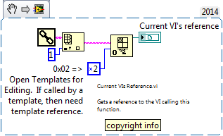

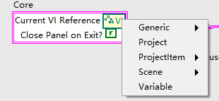

Hi I'm new to Labview. I want to know how to get the current VI reference as the graph shown below. Functions>Application Contrl>Class Specifier Constant, but I couldn't find the VI option in its VI server class option.

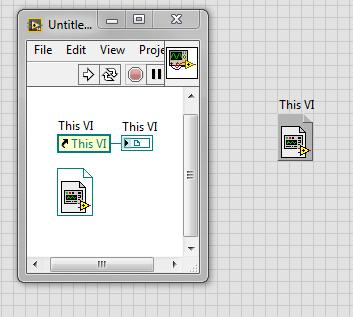

As far as I know VI references are big rectangles:

I think they work the same way. I am just curious where is it from. There is no mark ahead any of its options.

Yeah, that is weird. Can you attach the control, or the VI?
You can't even cast a Generic reference to a VI reference because they're two different things reference types.
Cast VI Ref.PNG< This throws an error

Attached is that part of the vi file. Thank you very much for your help.

That code is from the JKI state machine. OpenG has a "Current VIs Reference" vi that you can use to quickly get the reference.
