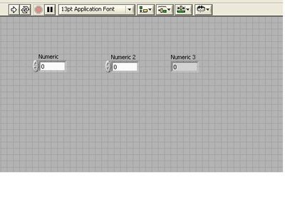

I am new to LabVIEW and I just want to control the cursor in my code .Please find the image with this .In that when I 1st run the vi the cursor shoud automatically blink at numeric and when I press "enter" it should move to numeric2 and again when i press "enter" it should move to numeric3.
Can somebody help me in finding a solution for this?

You can use an event structure and a Key Focus property. For example, in a value change event for numeric 1, you would set the key focus property of numeric 2 to True.

hello,
Thank you for the help..And it is really working!
