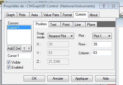

In my point of view, you have two ways to create more cursors, the first one is to click rignt in the 3D graph, select CWGraph3D, select properties
This window appears and you can add or delete cursors as you want :

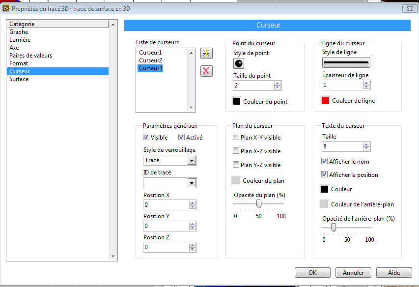

I send you a new VI to show you how to plot a surface in Surface (in Modern/Graph/3D Graph in controls palette ) and 3D Surface Graph (in Modern/Graph/3D Graph in controls palette ).
In the Surface, you can directly define custom cursor : you just have to click right in Surface, select proprety of 3D draw or graph (sorry, I have a LabVIEW in french, and I don't know the exact translation in LabVIEW in english).
This windows appear :
This window allow you to add, delete or configure cursor in the Surface.
