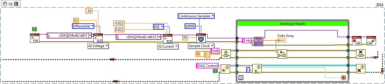

I have an issue where my program freezes/hangs as soon as it enters the daqmx Stop Task VI.
See the VI snippet below.
I have other data acquisition loops in the same vi but it's only this one (analogue input) which causes the program to hang.
It also happens if  I take away the Stop Task and leave the only the Clear Task.
Seems as if there's something related to that particular task which causes it to take a long time to clear the task.
Any suggestions would be great help.

What DAQ hardware do you use? Can your single module (cDAQ1Mod1) simultaneously measure voltage and current? Before the while loop you configure 8 voltage AI, and 8 current AI DAQ, but in your while loop you only read the voltages as I see?
Since you do not show the whole code, I am not sure what is wrong...Are you sure the DAQmx Stop task / Clear task make your VI hang?
