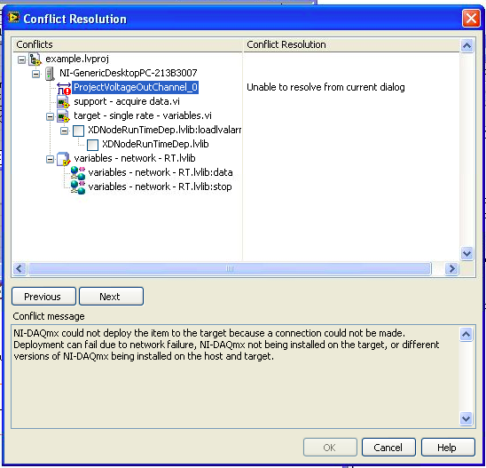

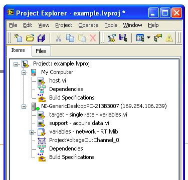

Hi Will,
as an example I used the project wizard to create a new Real-Time project with continuous communication architecture, one loop on the target, and a host user interface VI. Deployment of this on my standard desktop target with LabVIEW RT 8.6 works fine. As soon as I add a virtual channel the deployment fails. I have reinstalled the RT target system from scratch, but that did not help. I don't know how to send the project files to you, so I include two screenshots instead.
Let me know if you need anything else to get an idea of what is going on.
Regards
Stefan
