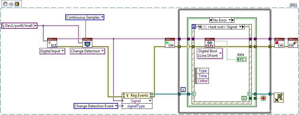

ive trying to execute an event using DAQmx event structure, but when running im getting an error,
Does anybody know how to run this properly?

Well its fairly straight forward that a digital in line will never accumulate a terminal count A Counter Output Event is only available for counter input tasks.
The DAQmx help file lists the events and a discription of what they do.  You are probably looking for a change detection event.

In fact, im looking for a change detection
Something like this?

Yes something like that!
let me try that code, i'll let you know if it works
