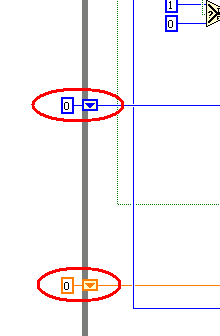

One thing that you're not doing is initializing the feedback nodes when you start your VI. A reinitialize to default does not clear old data from the shift register.

Hi Georges,
The issue is that you are using uninitialized Feedback Nodes and Shift Registers. You will have to pass a value to the Initializer Terminal in both cases to get the same results every time you run the VI. For the Feedback Node you will have to enable the Initializer Terminal first
and then wire the initial value to the Initializer Terminal for the Feedback Node
and for the Shift Registers
That should do the trick!
Have fun - and more of it with LabVIEW 8!
Message Edited by Philip C. on 12-11-2005 11:01 PM
- Philip Courtois, Thinkbot Solutions
Thinkbot Solutions
Message 13 of 21
(1,998 Views)
Hi Philip
Thank you so much for your help finaly it is working properly, also I start working LabVIEW 8 I hope not too much problem in the future, If you have an idea how I can fix the first problem.
