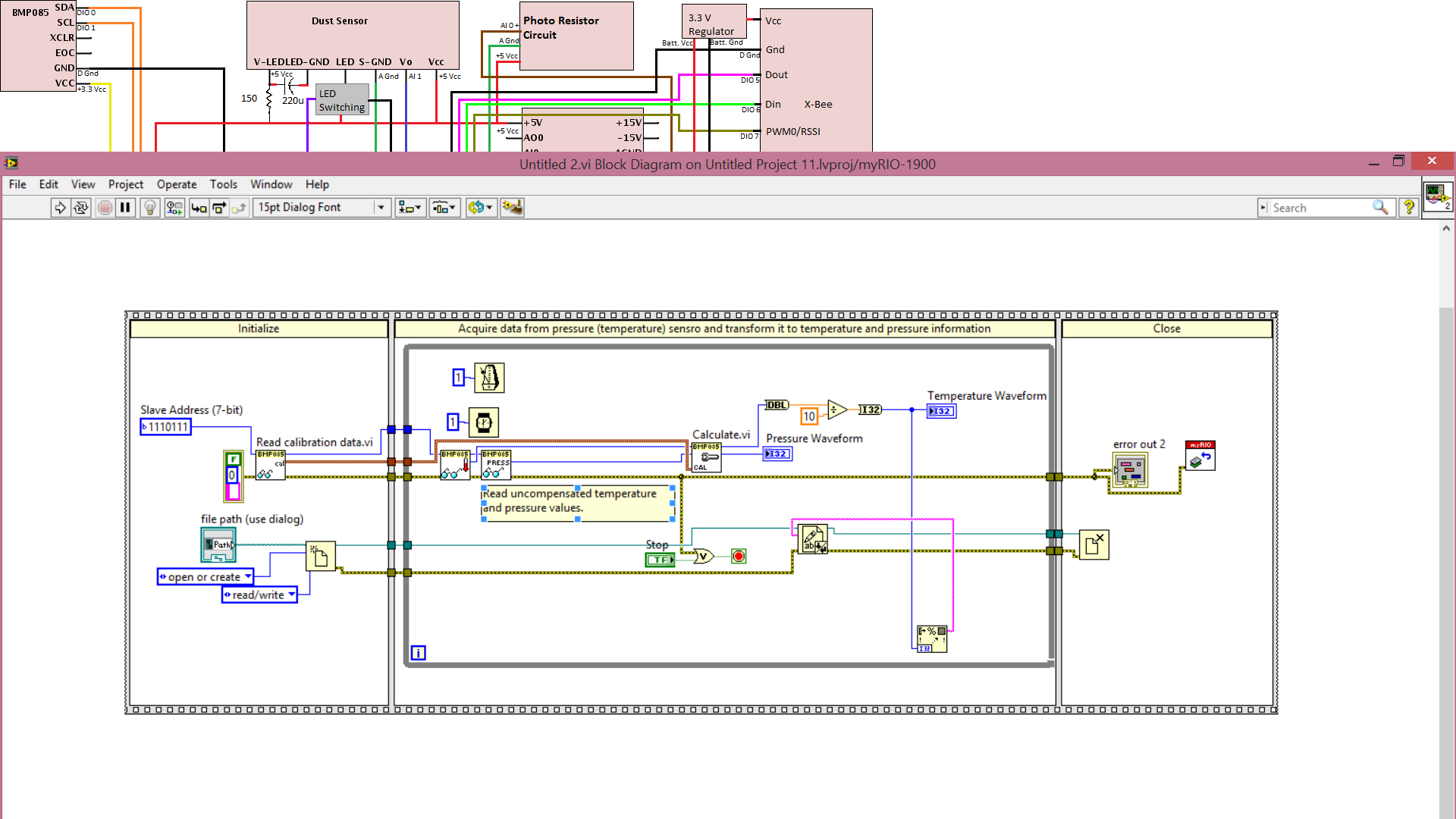

I used the code I had for my BMP sensor that I had on hand and it didn't run, I checked the file path and I got nothing.
Below is the code I ran(i've included it in the attachments as well).

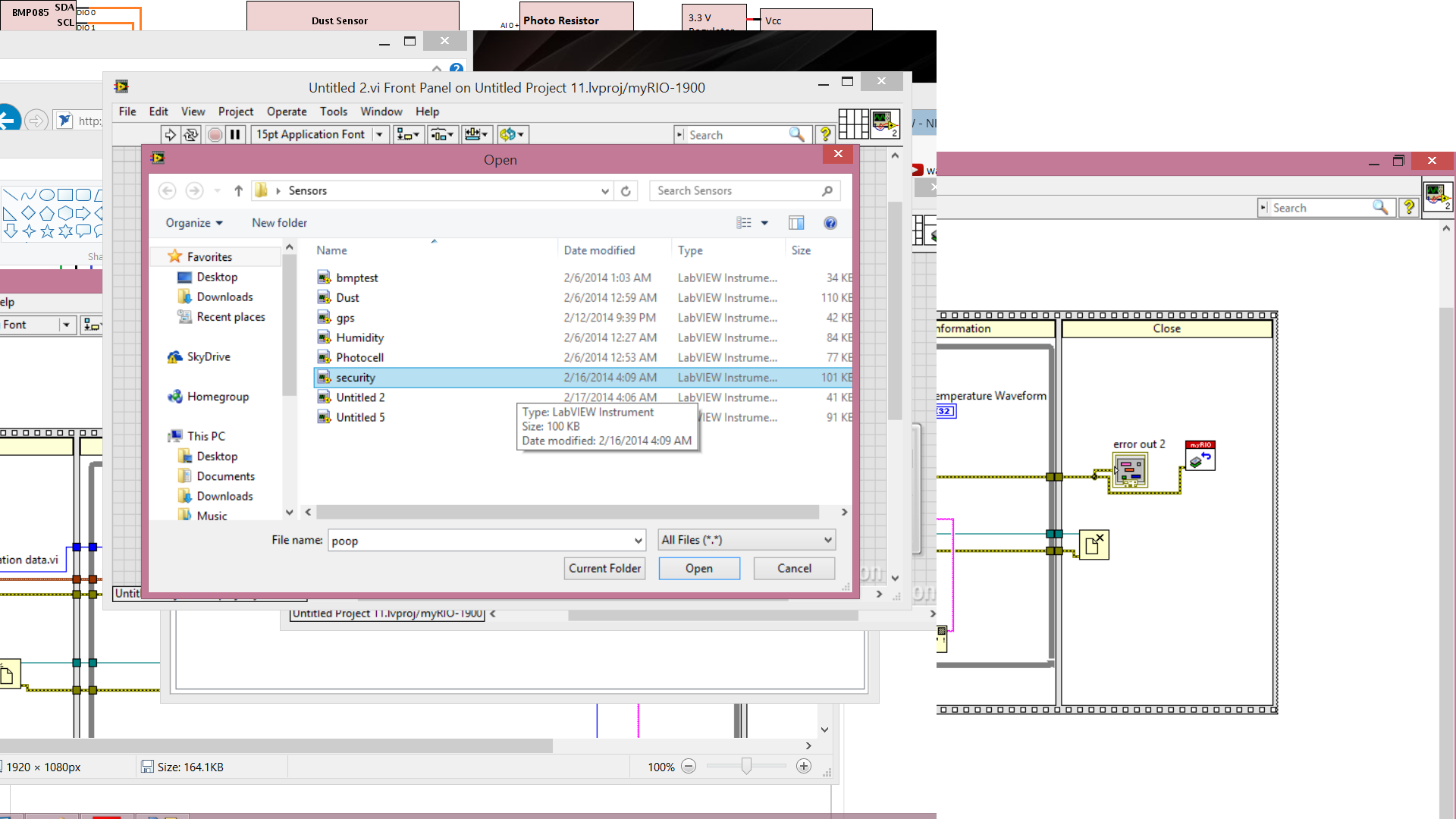

As upon cheching the directory i went to save nothing was there.

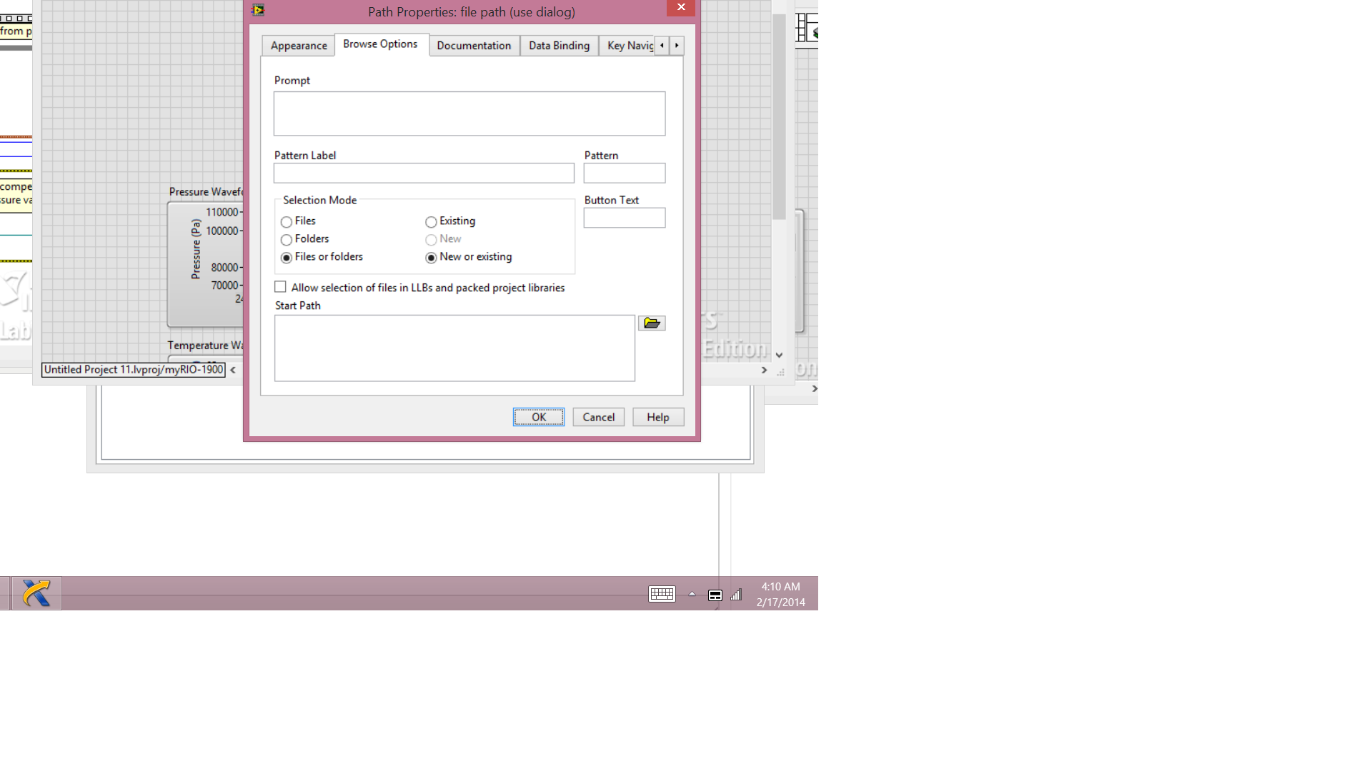

As shown I set my file path to new and exhisting and file and forders.  I named the file as a .txt(text file)

Sorry, there are a lot ofn subVIs that are missing and therefore I can't see much from there. I will pressume the upper portion of your VI is correct and thus I'll focus on the writing the data part.
There are a few noticable mistakes I can find in your code and I'm not sure if you have read the links which i have provided in my previous post. Perhaps you can try the following and see if that works. Presuming that you are doing a stand alone application of your myRIO:

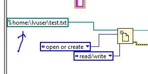

  1. First and foremost, if you want to access the internal storage of the myRIO, you'll need to specify the path using File Path constants with the specified values like below:
    This was mentioned in the following links that I have provided to you earlier:
    https://knowledge.ni.com/KnowledgeArticleDetails?id=kA03q000000YH93CAG&l=en-US
    https://forums.ni.com/t5/NIYANTRA-Documents/myRIO-Data-Logger/ta-p/3492852
  2. Second, your Format into String should specify the file format it needs to convert and you need to add end of the line constant as shown below:
When you mentioned that it is not connected to the home station, we usually create 2 different sets of VI. One is the host VI which extract data from myRIO when it is connected to the myRIO. The other is the client.vi which usually does not have front panel user interface if it is to be stand alone, does the datalogging, acquiring data, controlling and sometime analyzing data.
