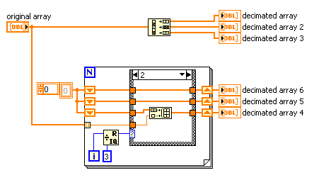

I aggree that the behavior of the Decimate Array function is non-intuitive when the size of the array os not an integer multipla of the number of decimated arrays. Therefore I have submitted the behavior to the LabVIEW R&D group for further investigation and hopefully improvements in the future of LabVIEW.

Okay, I just heard back from R&D that this behavior is known and expected. There is even a KnowledgeBase describing the behavior:
Why Does the Decimate 1D Array Function Drop the Last Element from Some of the Output Arrays in LabV...
However, since this behavior DOES cause some confusion, I will create a product suggestion for supporting different size decimated arrays. I will also submit a suggestion to add documentation about this behavior for the function as long as it still has the current behavior.

Hi Garvacious,
I have submitted both a corrective action request and a product suggestion for this feature. In my product suggestion, I suggest that it becomes optional to either use the old functionality that limits all output arrays to the size of the smallest array, or to simply use different sized outputs. Here is the diagram I submitted to show the ideas for the suggested feature:
Let's see what this turns into in the future...

This was reported to R&D (# 3OT0Q8SG), but was determined to be expected behavior as explained in the KB linked to above by Philip.  Also, this behavior is consistent with the Interleave Array function, which stops when the smallest input array is completely consumed.  However, if you feel strongly about this, I encourage you to create a product suggestion and describe in detail why the current behavior should be different.
As for better documentation on this function...  This was reported to R&D (# 2TGDGR0Q).
