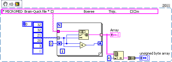

Hey Thijs,
So maybe you could use something like this:
Regards

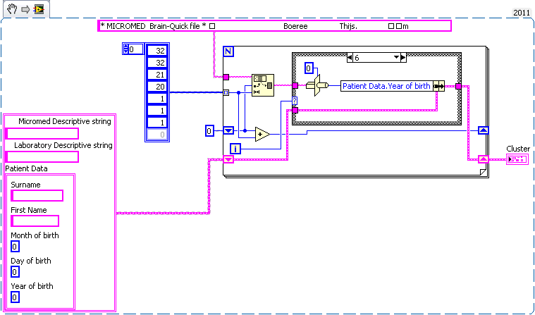

Or like this:
Message 7 of 11
(7,722 Views)

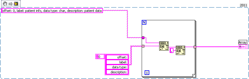

Hi, i am on my way home now, so i'm going to check it first thing in the morning. I was thinking about it, and came to the conclusion that i maybe needed to make an array of a cluster with an offset, length (count) and diffrent data types and run that in a fror loop to instruct the read binary file and the 'set file position' to retrieve the data and than later on put these in a well defined cluster!
But maybe you have the same solution...
You can do that, but of course you can't auto-index different data types into one array. But you could populate the cluster directly in the for loop.
Message 9 of 11
(7,715 Views)
I was planning to make a case each with a different data type... and according to the data type in the cluster array it would switch to a different case... but we'll see!
