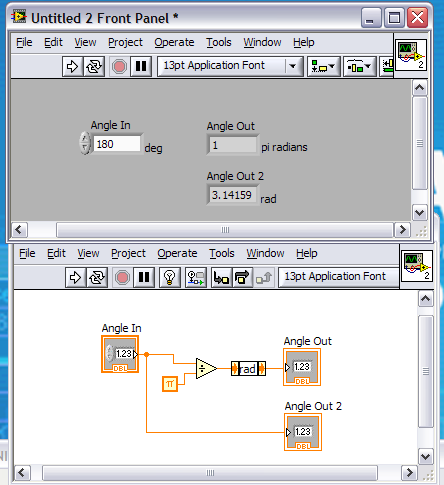

I am a return student. I have the Student version of LabVIEW 7.0. I need to convert degrees to radian, but the answer have to show the values in fraction with the pi at the right side.  HELP

I used the unit label on "Angle In" and "Angle Out 2" so the conversion is done automatically. "Angle Out" is unit-less with just a "pi radians" text field to the right of it.
