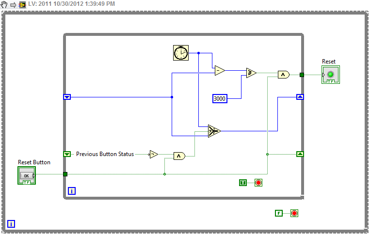

I am looking to add a reset control switch to my VI for my max/min feature to reset the values. However, I also need the reset button to only actually reset the values after 3 seconds of being held down.

Notice that the inner while loop in the snippet iterates only one time. It exists just for the shift registers. You could also use feedback nodes instead of a while loop and shift registers.
Also notice that I changed the mechanical action of the button to switch until released.

Stu,
I did it in a slightly different way using a dedicated event structure (read the caveats in the detailed help for event structures to see why) and notifiers.  My version is probably slightly less tightly coupled than Steve's.
