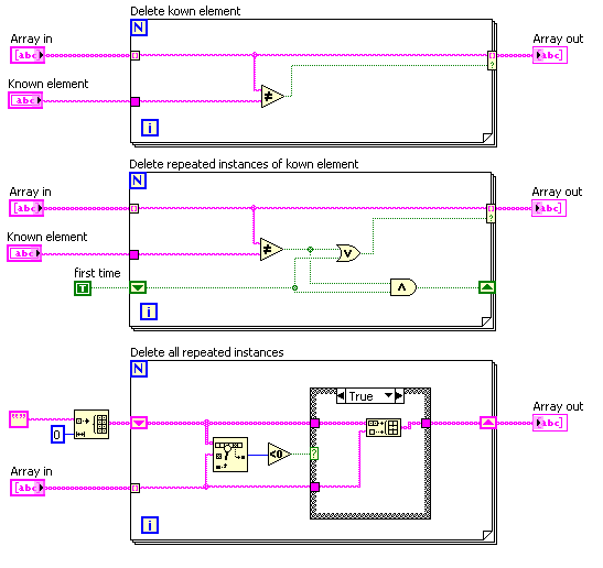

You question is not quite clear. These are three different solutions: select what do you need.
_____________________________________

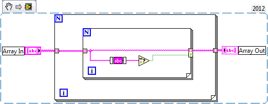

I have a 2d array of strings. There are lots of blank string constants are present in that array. I want to delete all of these blank string constants and make the array smaller with others string data.......

There are many a times the very same question was asked, please make a search before you post. This is one of the method to remove empty elements.
This will not work because the conditional terminal is true when the string is empty, so it will only add empty strings. You need to invert the output of the empty string function.
Also, all the rows of the array need to have the same number of items so some elements will be filled with the default string value: an empty string.
Ben64

Thanks Ben for pointing me out, I missed the Not operator.
Anyway you cannot restrict the array filling with empty strings at the end if the arrays are of different size.

Drag that picture to your block diagram.  It's a snippet.  The code will populate in your vi.
Also, it would have been much quicker to just rewrite the 5 functions they posted than waiting that long for a new post.

actually I donot know how to add the condition in the for loop..i.e. the question mark type thing in that for loop..........please help me............
