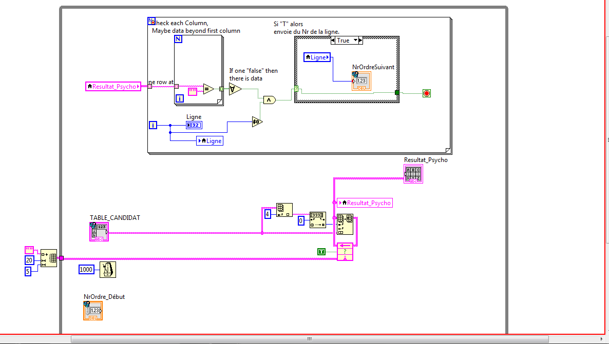

Note1: you do not need the for-loo named "Maybe data beyond first column". Remove it. The "equal" and "all" will adjust accordingly.
Note2: do not (over-)use local variables. Just wire the i variable of the for-loop to the "NrOrdreSuivant" through the wall of the case-structure.

about your solution i already used it,but it doesn't give me any result.the moment i run the Vi i get data in 6eme row(the last data i entered in a client),it doesn't matter which row but one row show up filled with data.
maybe some invoke node or spmething else i don't know,i think it's a shared variable problem

@achfire wrote:
What to do to delete historical data from a table.even when i turn of clients,and i re start the server,in the table the last value entered in a client showed up
Your Vi is full of race conditions because of local variable misuse. Fix that first.

@altenbach wrote:

You also need to stop writing to indicators and their local variables in parallel. Both operations are equivalent so only writing to the terminal is all you need. Obviously you don't fully understand what a local variable is.
Before continuing with this project, you need to complete all LabVIEW tutorials first (e.g. here). Your current state of training is not suitable for what you are trying to do.
