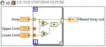

yes exactly, I have an array and need to eliminate all the elements wich are not inside the threshold.
Til now I've done this. Every element out of range becomes NaN.
Now with search and split elements out of range must be eliminated, but how ?

Accepted by topic author uge026
Is this what you want ?

okay just another solution.
if you have version of LabVIEW in which you can enable conditional terminal in for loop life is much simpler.
Message 9 of 10
(4,662 Views)
If you have a version with conditional indexing:
