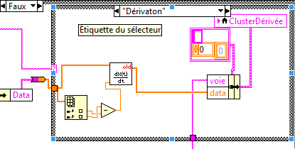

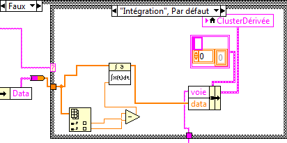

I try to derive and integral my signal (array 1D of double) but i can't to calculate the dt in each case and which gives me as a result this.
this is my diagrame .
derivative -->
Integral -->
How i can to do to adjust correctly the dt for this fuction.

Hi Sarah,
from your images it seems you try to calculate dt from the difference of the first two samples.
Why do you think you get dt when subtracting two sample values? THis would give you just dx…
You should know dt from your signal source. It would help when you would be using the waveform datatype…
