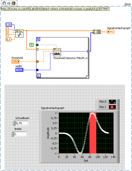

you could use the "threshold point-by-point.vi" instead of the "threshold.vi"
