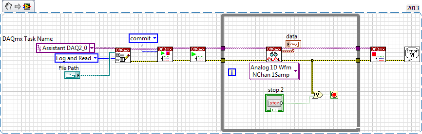

Try something more like this:
to get there I first right-clicked on the DAQmx assistant and selected "Convert to Task"  and configured the task to stream data to disk as it is read.   Then I tosssed out all the rest of the express vis since the DAQmx task does everything you wanted it to do.
Edit: Attached backrev saved to LabVIEW 2010 per source vi I do not know if the logging functions work that far back but the conversion did not toss up any warnings. other than the expected " some Polymorphic instances.." of the configure logging vi have required terminals.  So if its broke in 2010 you may need to relink to the correct poly instance
