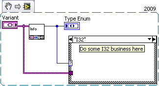

I'll also suggest Variants, there is some good stuff in vi.lib including 'GetTypeInfo.vi'
21007i159B34340308C300
Whatever you wire to the subVI will get coerced to a Variant for you.  Not as 'pretty' as a polymorphic, but you'll get used to the Red Dot.
