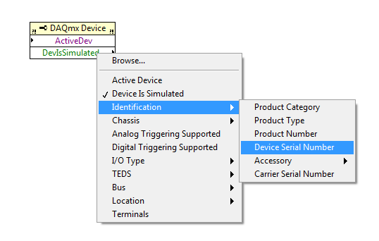

What USB devices?
Assuming NI-USB-DAQs reading the serial number is the rigth way to identify the USB device.
And easy done with the property nodes.
However, it seems that you want to identify a test setup. So you need to use the (replaceable) USB device to identify what type of setup is connected.
Using spare inputs for this task is a typical way, and need idividual programming. A standard solution for sensor identification is TEDS.
And you can't make it fool proof, since fools are so genious!  😄 😄
