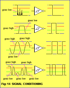

So 0-9V, it depends which direction you're going. It's a gray area between 0.8V and 2.2V because the value won't switch until the threshold value respectively.
Going from False to True, you will need to read in a value greater than 2.2V. Going from True to False, you will need to read in a value less than 0.8V
This image does a good job of depicting this. See red line (positive-going) and green-line (negative-going).
