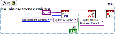

Here is the VI.
In this case on the Front panel i see the LED shifting but on the digital output of the Data acquistion the 1st channel stays high all the time.
But I want it the VI to stop output of all the channels when i press stop.
Thanks.
Kind regards,
Message 18 of 24
(1,313 Views)
As said before: usually you should attach your VI, so we can give suggestions for improvements…
Edit: That's a picture, but no VI…
Solution: THINK DATAFLOW!
Did you debug your VI with highlighting enabled? Then you would notice why it behaves like it does and where the problem comes from…
