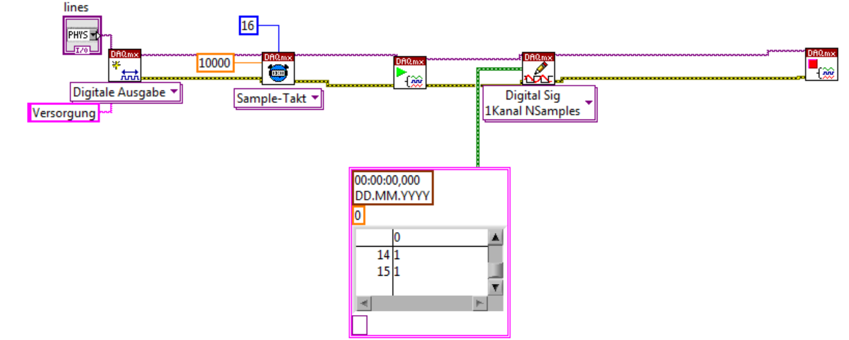

I can produce a certain digital output signal with sampling rate 10kHz with the DAQ-Assistent. Now I'd like to build up the same functionality with the normal DAQ-VIs, as I have to synchronize lateron serveral outputs. However, I failed to get the normal VIs so that they work like the DAQ-assistent. The most important point is getting the arbitrary signal out with 10kHz.

Are you getting any errors?
The thing that sticks out to me is a digital waveform with a dt of 0.  Instead of the waveform, try just passing in an array of Booleans.  Your DAQmx Timing VI already takes care of the clock rate.

Thanks a lot. The idea to look inside the DAQ-Assistent helped.
