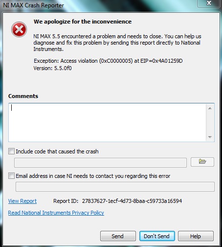

Could anybody help with this error message?
Seems like anything is wrong with NI MAX, in addition, when I do right-click on "Devices and Interfaces" nothing happens...I cannot see the dialog "Create new".

What drivers and versions have you installed with LabVIEW? And does the access violation happen after clicking Tools>>Reset Configuration Data and restarting?
If this is still happening, can you click Send on the crash report window you posted and then Copy/Paste the Report ID here so we can take a look?

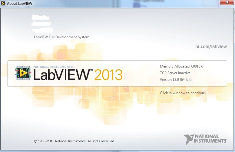

And, about the LabView version:
Message 8 of 11

Sorry I forgot the report ID
Report ID : a2a594c7-3954-4462-a29b-a2548e1fdf1d

We pulled up your report in our crash database. It looks like Ray is correct. The crash is occurring in a very old (1998) version of PDM.dll. It looks like this dll shipped with Visual Studio 6 and Office 2000. I would recommend finding a way to update that DLL or you could try removing it (making sure to preserve a back-up) if you are not using Visual Studio 6 or Office 2000.
