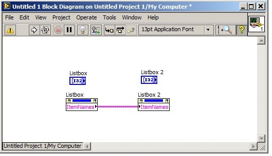

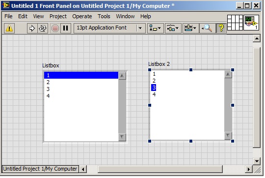

Hi rita86
To copy from one listbox to another use the Item Names property as shown ....

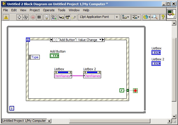

Thanks a lot sir, actually I want this operation to be performed only after clicking on add configuration button.Then only selected item should come in output listbox.
Message 4 of 14
(4,980 Views)
Then use an event structure to perform the transfer from one listbox to the other when you click the add config button. Smiley Wink

Thanks sir for your quick response, but according to this vi , whenever we select like 1 from listbox 1 then whole numbers in the listbox2 come like 1 to 5.I want to code in such a way so that when I select 1 from listbox 1 then on clicking ok, it should display that selected value in listbox2., it should not show other values.
