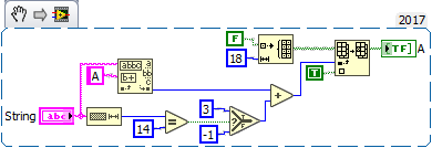

This VI can be simplified like this:
(Still error checking is missing, like "input string does not contain any char A".)
This VI has a string input and a boolean 1D array output: these are the possible connections. Why don't you know "how to connect in your program"?

Hi GerdW,
You are right like this the VI is more simple.
Now, I would like to detect the position of the array where is detected the letter "A" and according to that, send a frame in a string.

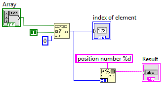

I have one array od booleans and I have detected which position is True. But now I want to send  a frame depending this position that I have detected. I mean if the position 3 is TRUE, I want to send one string which says " position number 3 "

Accepted by topic author labview99
Something like this?:
Perhaps a +1 for the number depending on if you want 0 or 1 as first position.

Now it goes perfect!! Thank you so much for your help!!!
