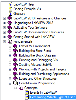

From an obscure place in the LabVIEW Help file:
For filter events, LabVIEW sends the event sequentially to each Event structure configured for the event. The order in which LabVIEW sends the filter event to each Event structure depends on the order in which you register the events. Each Event structure must complete the filter event case before LabVIEW can notify the next Event structure. If an Event structure case changes any of the event data, LabVIEW passes the changed data to subsequent Event structures in the chain. If an Event structure in the chain discards the event, LabVIEW does not pass the event to any Event structures remaining in the chain. LabVIEW completes processing the user action that triggered the event only after all configured Event structures handle the event without discarding it.
So, you run the vi with the filtering event loop before running the vi with the non-filtering event loop, the filter event would register first (Events register when a vi containing static events is run).   Changing the code to register both events as filter events and making no mods in the first event loop should allow you to act first then filter second.
