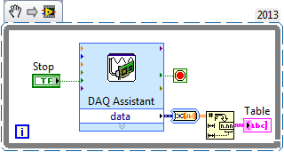

The data type that comes from a DAQ Assistant is the Dynamic Data Type. You will not be able to wire this directly to a table indicator, but you can convert the data from the Dynamic Data Type to the string format the table expects. James_W asked some good questions that will help dictate what you need to do in order to convert the data to the string format, but one simple thing you could do is use the Convert from Dynamic Data into a Number to Fractional String primitive. I have my Convert from Dynamic Data configured as "2D array of scalars - columns are channels", but you can use whatever type works best for you. If you want to display the time, you will need to calculate it from the waveform by how James_W described and insert it into your array of strings that gets displayed on the table.
The following VI snippet shows converting the data from Dynamic Data to a table:

Hello Matthew,
I was able to get this to work like it was intended, I think.  Is it possible to extract the column headings as well to display the channel names?
