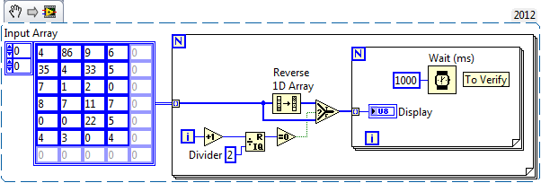

I'm very new to LabVIEW and was just wondering how to do a raster scanning of a given 2D array.
Normal passing of 2D array via nested loops resuls in sequential indexing and displaying the elements on an indicator gives  1st row col 1 to end ......... 2nd row col 1 to end ....... so on.
But I want to get: 1st row col 1 to end ......... 2nd row col end to 1 ....... 3rd row col 1 to end .............so on. (Raster scan type)
Any ideas in this direction?

Hi is this you want?
(6,186 Views)
Thank you Stephen,
Although I couldn't open the VI as i'm using LabVIEW 2009 but i got the idea and think can manage to replicate it based on the snapshot of the block diagram.
Thanks a lot 🙂
