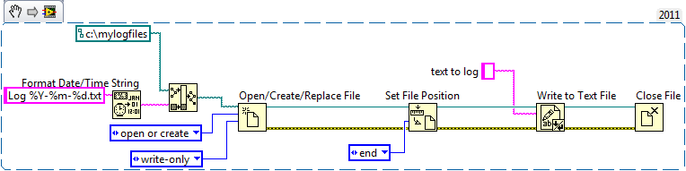

If I understand your logging - you are only logging every 60 sec. I would Open and Close the log file each time.
  1. Create a log file name with today's date as part of the log file name (Log_2014_07_07.txt)
  2. Open log file
  3. Position the file pointer at the end of the file. (Set File Position)
  4. Write log data to log file
  5. Close log file
The Format Date/Time String function will automatically create a new log file for each day and will reuse it for that day and then will create a new file for the next day.
Omar
