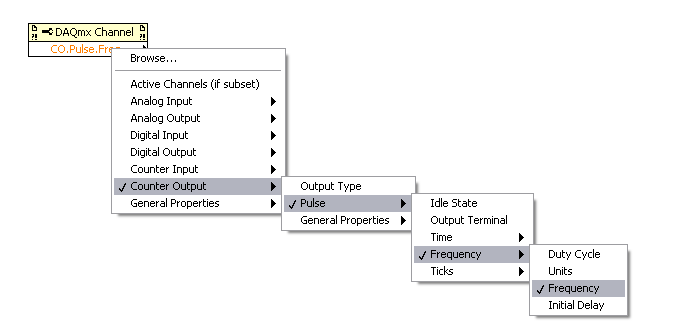

0)  The counter tasks can use the 80 MHz timebase (20 MHz and 100 kHz are also available).  So, the available frequencies you can generate using the counter is 80MHz/N, where N is an integer (between 4 and 2^32).  You are still limited to the divide down method, but you would be working with a higher timebase so you could achieve frequencies that you couldn't otherwise (such as 1.6 MHz).
1)  You can check the actual sample rate of the counter using the following property node:
2)  You may run the AI, AO, and two counters simultaneously in seperate tasks -- I would start AI, AO, and Ctr2 before Ctr1 so that all the tasks will start simultaneously.  If you started Ctr1 first, then the clock would be running so the tasks would start at different times (based on the software) unless you were using a trigger to start them.

Thank you so much, John.
How can I choose the basetime of counter?
I got to know "timing.vi (implicit)" has no any input of internal clock source.
Do I have to use timing property node?
labmaster.
Message 9 of 11
(7,025 Views)
Hi labmaster,
The timing.vi function is used to configure the sample clock--this is actually different from the counter timebase.  Rather than use a DAQmx Timing Property Node, you should use a DAQmx Channel Property Node to configure the counter's timebase.  (Counter Output >> General Properties >> Counter Timebase).  The timebase should default to the fastest possible value depending on the characteristics of the pulse that you want to generate.
