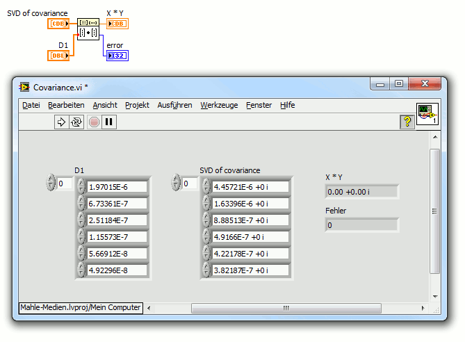

Hi kelob,
your data give a valid result for the dot product:
What else do you expect?
Are you really expecting a good signal from reading an AI using the ScanEngine without any timing information whatsoever?

Accepted by kelOb
You'll need to expand the number of decimal points you're displaying in your result- those components of the dot product are on the order of 10^-13.
