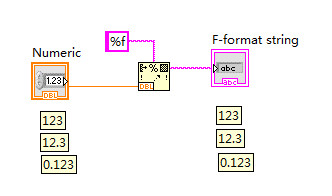

double to string conversion
How to  convert a double variable which doesn't have a fixed fractional part to string with exact the same appearance.
Is there any function to do this in Labview?

The problem with your request is that the value in your Numeric control will display the actual value based on the display format for the control, not based on the actual value stored.  Not all floating-point numbers can be exactly represented in memory, and you happened to select a good example: "0.123" is actually represented as "0.122999999999999998" in memory.  You can see this if you increase the digits of precision displayed by your control.
You can change your "Numeric" control from numeric to string, then convert it to double to work with the value.  If your numeric value is coming from another calculation, you'll have to jump through a few hoops to accomplish what you want.

I think you can get close. Create a property node for the Numeric control. Select the Display Format property.  Wire the Format output to a case structure. Inside the various cases use the appropriate number to string conversion function. For some cases you will need to wire the precision property to the conversion function.
This will not work with the  automatic format and may not work exactly as you want if Hide trailing zeros is checked.

If you simply want to see the same thing as in the control, look at the display format of the control, go to advanced format, and copy the format string you see there into your format string for the conversion.
(Be aware that the actual value in the control can be different outside the visible digits, so if you scan the resulting string back into a numeric, an equal comparison is likely to fail).
