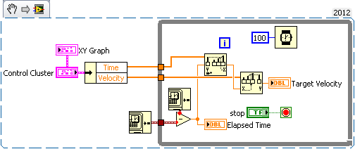

I am a student and beginner on labview. For a project I have to make a program that will allow me to order a wind tunnel following an enclosed ground, with to a USB card NI 6008. I have been working on this for 1 month and I don't reproduce the same model of wind.
Here the first VI that I did for the first part of my project. the user will enter the maximum simulation time, and then set the wind cycle back (attached 1) coordinated (x = time; y = speed) of each point of the cycle. To do this I used a computerized box that will allow to calculate the leading coefficient (a * x + b) for each curve portion of the cycle. This VI will allow me to set a cycle with maximum 8point of coordinates (x, y) (as the graph below attached) but does not allow me to realize this cycle (attached 2). Attached is the VI.
can you help me how to realize this model very complex for me.

You have the right basic principle but you are going about it in a complicated way. Using arrays and the interpolation/threshold commands you could make much lighter work of the outline generation.
I would recommend looking at the online LabVIEW tutorials to help you out.

The courses ogk mentioned are excellent places to start. Also be sure you understand the functions he recommended. You will find that they are extremely powerful and can help solve a lot of problems.

Thank you very much ogk.nz. This tutorial and vi really help me 🙂 .
