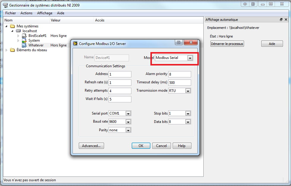

I tried to follow your step but I cannot create a Modbus TCP I/O server... I only have Modbus Serial Option (see picture below)ManualConfiguration_IO_ServerWhatever.png
Due to the fact that you identify my issue as the known issue 400570, the only work around I see It see if we could implement Preset Single Register (FC=06) (actually not support on the device I need to write on). I hope It will works...

You can still follow the later steps (open up the I/O server, go to 400001-465535 and manually set the specific register) on your BirdScale#1 library's I/O server, I just thought it would be cleaner to make a new one. You should be able to select Modbus Ethernet from the dropdown, but if you can't then no worries.
If that function code 16 is a requirement for your device then unfortunately I think you're out of luck with I/O servers. Its worth noting that we do have standalone libraries which you can use (http://www.ni.com/example/29756/en/ for LV 8.X-2011; https://forums.ni.com/t5/Reference-Design-Content/LabVIEW-Modbus-API/ta-p/3524019 for 2012 and 2013; included in 2014). They are not as simple as the I/O servers, but they'll get the job done. Important: When using the libraries, values are referenced by address not by register number. That is, what the I/O server calls 400018 is actually the holding register (4xx,xxx) at address 17.
