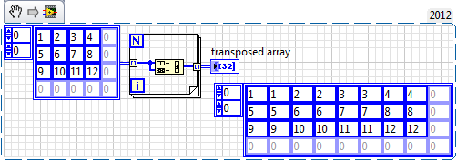

Hallo,
I can't really explain my problem, but my example normally will be clear..
(I have a random size array: 4-4, 10-3,... and random values)
Thanks for you help!
in:
1   2   3   4
5   6   7   8
9  10  11  12
out:
1   1   2   2   3   3   4   4
5   5   6   6   7   7   8   8
9   9   10 10  11 11 12  12

Is your array always 2 dimensions?  What have you tried so far?  I think you can do this with an auto-indexing for loop and the "Interleave 1D Arrays" function.  Give it a try, and post your code if you need more help.

Indeed Nathand
(4,492 Views)
Great, this does the job very well..
Now for doing te same but vertically, can i use the transpose array function before the interleave function so i copy in the y dimension as well as the x dimension?
(4,484 Views)
Just as copying each row so my array also expand down as he expanded horizontally.
(4,482 Views)
Alright I got my solution!
Thanks for helping!
